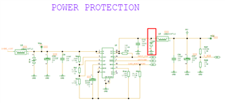

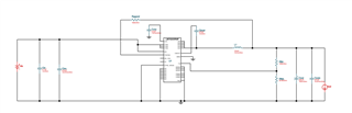

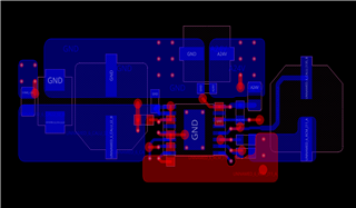

We are designing a custom PCB with 24 V input. we used TPS26400PWPR for power supply protection. LM76005 is used to convert 24 V to 5 V and LMR51430 is used to convert 5 V to 3.3 V. (https://e2e.ti.com/support/power-management-group/power-management/f/power-management-forum/1429731/tps2640-design-validation-for-power-section)
Below are the screenshots of the circuit (schematic and PCB). Please validate the PCB Component placement, layout design and suggest if any modification is required.

  • Hello Akash,
    Consider adding a Schottky diode at output for negative voltage ringing for TPS2640 as suggested previously.
    OUT pin can violate negative voltage abs max.
    Layout is fine.

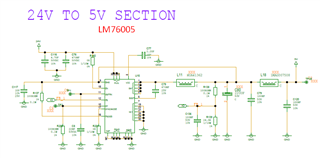

  • Hi Akash,
    For the LM76005,
    1. Add another 4.7uF capacitor to the input VIN rail
    2. What is the purpose of C136?
    3. Consider adding a layout placement for a feed-forward capacitor between VOUT and VFB
    4. What is the inductor value of L11? I suggest following the datasheet of using a 6.8uH inductor for this application
    5. Depending on the expected load step transient behavior, reducing output capacitance to increase the loop bandwidth is an option. See attached quickstart calculator.
    6. Layout looks good.
    LM76005-Q1 quickstart tool - rev A_Akash.xlsm
    Ben

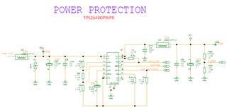

  • Hi Amrit and Ben,
    Thanks for your valuable suggestions.
    For TPS2640: I have added the Diode (D25, P/N- SK36BHE3-LTP). Below is the schematic for your reference.
    For the LM76005:
    1. As suggested, we will add another 4.7uF capacitor in parallel to C116.
    2. C136, 0.1uF Cap in Feed back path is for good dynamic reference. Is it fine?
    3. For feed-forward capacitor (CFF) between VOUT and VFB, can I add 47pF capacitor as suggested in application circuit in datasheet?
    4.  The L11 as per webench simulation for 24VIN-5VOUT, 3.5A is 5.6uH (Below image). So, We have connected a 5.6uH, 10A inductor (SRP6060FA-5R6M) in this design. Should I need to change it to 6.8uH?
    5. Regarding load step transient behavior, the output capacitor values are taken from the webench simulation results. Shall I need to reduce it to 125uF as suggested in quickstart calculator?

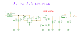

    Also, Waiting for TI response for LMR51430.

  • Hi Aakash,
    From a frequency point of view, adding C136 will add a pole at a higher frequency which will lead to lower gain of the loop. From a transient point of view, the loop response will be a lot slower. I suggest adding C136 to the layout as a DNP (do not populate) so the board has the option to add the capacitor if needed.
    Excellent
    Yes, I would follow the datasheet recommendations.
    Yes, only if the inductor value is at 6.8uH. A larger inductor value will have a smaller inductor current ripple so the design can tolerate a lower output capacitance. Just add a few more layout landings so the output capacitance can be increased if needed during evaluation.
    Ben

  • Hi Ben and Amrit,
    Thanks for your valuable suggestions for TPS2640 and LM76005. Those two sections are clear and we have updated in the Schematic & PCB.
    I was just waiting for feedback on LMR51430. But, I didn;t get any feedback for this. I have followed the datasheet design guidelines for the same.
