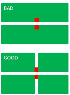

  • Hi
    'Radiation' point of view, the loop area in which a discontinuous current flows should be minimized.
    Right now, input capacitors are a little bit away from high side switch and freewheeling diode.  This can be improved by placing a SMD ceramic capacitor (2.2uF or 3.3uF, check temperature) very close to the source connection of MDD3752 and the anode connection of MBRF10U.
    'Conduction' point of view, please see below about input capacitor connections.
     Hope it helps.
    Eric
