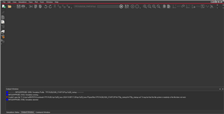

Hello, the transient model file for TPS7A20L33PDQNR does not work, can you check it?
When you say "it does not work" what do you mean? Does the simulation fail to converge?

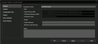

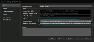

PSpice --> Edit Simulation Profile
Click "General" then delete the text within the "Output" section shown below. Then rerun and the simulation should work for you.
