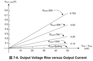

Looking at Figure 7-6., Rcdc is listed in the range up to 20kΩ. Is it possible to set Rcdc below 20kΩ?
Thank you for reaching out. We don't recommend to set Rcdc below 20kohm. Recommended range: [20kohm, ∞]
