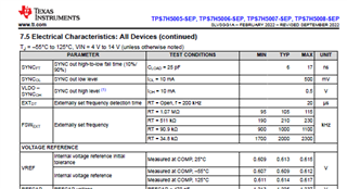

The TPS7H5005-SEP data sheet mentions VREF is measured at COMP.  How is this measurement made?
Since its measured at COMP of the Error Amplifier I believe this indicates the 2mV input offset voltage is then part of the VREF min max tolerance.
Please comment.
  • Hey Stuart,
    The VREF is measured by slowly increasing the VREF pin and waiting for the COMP pin to go to 0 V.
    This would incorporate an error amplifier offset in the measurement.
    The offset is measured by looking at the internal reference rail change.
    Daniel
