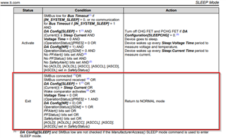

    But I see your point with how the BMS gauge will be affected by having an LDO connected in the way I showed above. Is it then possible for me to move the LDO to the system side of the BMS, for supplying the TPS65988, and still have the BMS in sleep mode?

  • Hi Victor,
    Below are the conditions for the gauge to exit sleep mode. As long as the current does not break the sleep current threshold or any of the other conditions aren't met, then I believe device would still stay in sleep at this time.
    However, I believe this could be an issue when the gauge enters shutdown. The exit condition to leave shutdown is based on the voltage seen on the pack pin, so if this threshold is lower than the 3.3V, the gauge would not be able to be in shutdown at this time.
    Anthony
