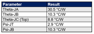

I check TPS546C25’s datasheet for check thormal information.
But Junction-to-board thermal resistance is TBD.
Do you know this information?
The thermal metrics for 33VBD package
