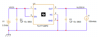

I want to use TLV77128PDQNR and to simulate for line reguration, load regulattion and bode plot.
How to optimize the tlv771p_trans.lib, and modify?
I think this libraly is for TLV77133, don't it?
Could you please advice me?

The PSPICE models do not model loop stability, and the line and load regulation is likely not modeled well. There are plots in section 5.7 in the datasheet - are these plots along with the Electrical Characteristics specifications not sufficient?
