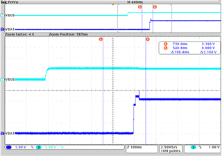

    The BQ25622E does not have any built in battery detection function. Therefore, if /CE pin is pulled low and EN_CHG bit is 1b the device is expected to attempt to charge even if BAT pin voltage = 0V. The charger will provide a positive voltage to close the protector.
    As a proof of concept please see the waveform below taken with a battery protector with a battery undervoltage protection threshold of 2.8V. As you can see the BQ25622 starts charge and is able to close the protector.
    Can you please help to provide a similar waveform to show the BAT pin voltage on the BQ25622E during your testing?

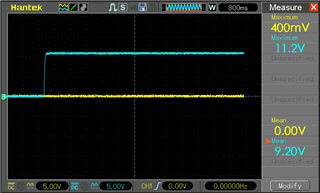

  • Ive included a wave. The yellow is the wave off the battery terminals. The currently 0 reading battery is attached. The blue is the external supply, provided by a PSU being powered on. Set to 11V (for some reason reading as 11.2)
    As you can see at no point is any voltage being applied to the battery terminal. And Charge enabled by the register, and CE# is set low.

    The behavior you show in the provided waveform is not expected. The waveform I provided in my last response shows expected behavior with a depleted battery with all register settings in default configuration. As long as /CE pin is pulled low the device will attempt to start charging. There is no way to "force a charge cycle" beyond pulling /CE pin low and setting EN_CHG = 1b.
    Can you please help to double check that /CE pin remains pulled low throughout the duration of your test?
    Can you please help to answer a few additional questions to aid in debug as well.
    -In your waveform is the battery voltage measured at the BQ25622E BAT output or at the actual battery terminals? If you are not doing so already please measure BAT pin voltage before the protection circuit.
    -In your test where charge does not begin can you check if SYS voltage is being regulated to the expected value (i.e. above SYSMIN setting)?
    -Can you please provide a single read (i.e. register dump) of all BQ25628E registers during time when external supply is provided, but battery is not charging?
    -Can you please repeat the test with no battery connected rather than a BQ which has lost all power? Expectation is BAT pin output voltage will increase to approx. full charge voltage setting.

  • Garret, I want to thank you for your time looking into this.... I made the register dump and then did one last couple of tests and reread your post, and made me think to check something.... And I've discovered what the problem is, and it is to do with our design.
    We have a reverse polarity protection circuit on the PCB. Separate from the batteries built in protection. I was testing from the battery terminal but not from the charger side of that PCB protection...
    Yes indeed the charger is providing a voltage, but with the battery being 0 it wasn't charging the nfet that opened up the reverse polarity protection circuit.
