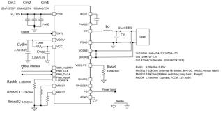

WEBENCH will be released by the time we RTM the device,
What is the support you need? SCH review?

I would like a recommended circuit and BOM list for our design requirements.
Our design requirements assume the following:
①Vin=11.5V-12.5V nominal 12V
②Vout=0.825V-0.875V nominal 0.85 (FPGA logic Power)
③Iout=MAX20A

Shimada-san,
Yes, I can create a recommended circuit. I will send you on Friday.
David
Shimada-san,
Here is an example schematic of a 0.85V using the internal feedback divider and VSEL pin strap setting of 0.85V.
The datasheet has an example pcb layout
If regulating to 0.825V or 0.875V is required, an external feedback divider may be a better choice.
An external divider configuration would add an external divider, msel1 and msel2 resistor values would change.
The internal default reference voltage is 0.4V, unless changed via pmbus.
The resistor divider for 0.875V would be 10kohm for low side and 11.8kohm for high side resistor.
