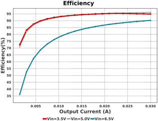

LM51581: Tested Efficiency much lower than WeBench results
Part Number: LM51581

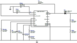

For Vin 5V input & 24V/10mA design,
  • the webench results show 87% efficiency for 5mA while I observe only 60% at 5mA. The Inductor & Diode used in webench & testing are same.

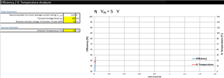

  • the excel calculator efficiency data states 60% which matches to my test data.
My design operates in DCM mode for current in range of 5mA. Please can you share which one is more accurate for referring efficiency - webench or excel calculator.
