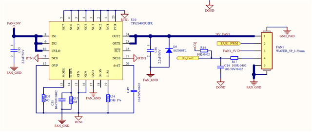

My customer is using TPS26400 in motor applications. Did you have some experience here?
The design condition is as follows.
Vin=24V
Io=0.6A
Ilim=0.8A

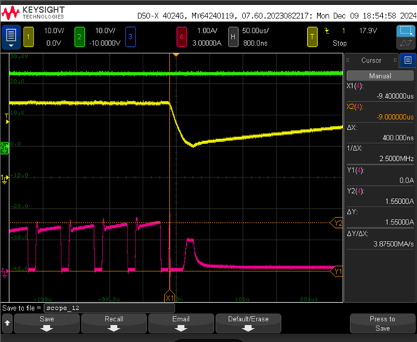

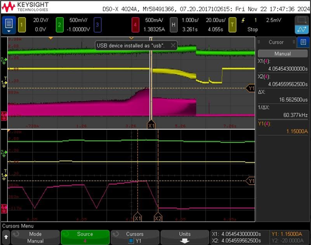

The customer used a locked-rotor motor to increase the input current to simulate an overcurrent situation, but the 250ns dly waveform of Itrip could not be measured normally.
Yellow is 24V
Red is a current waveform.
We measure the dly time is 16us more than 250ns of the datasheet. So could you give some recommend here? thanks
