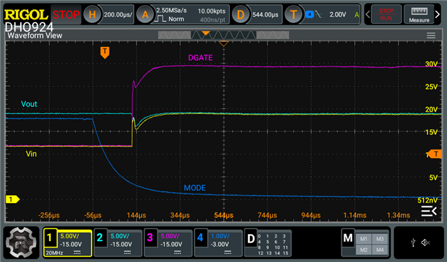

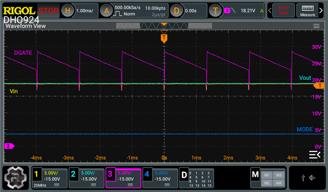

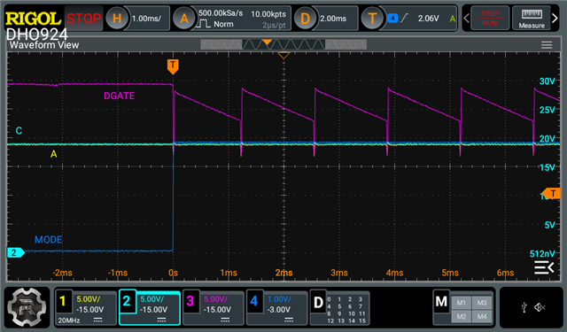

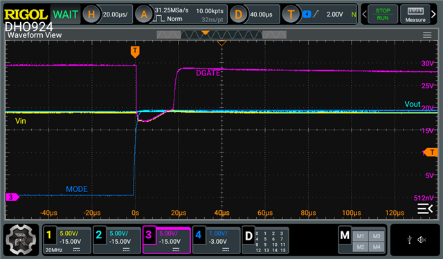

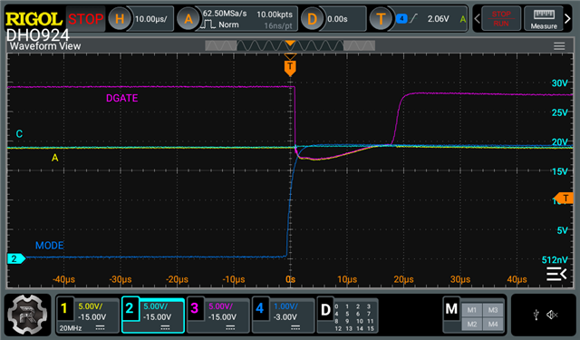

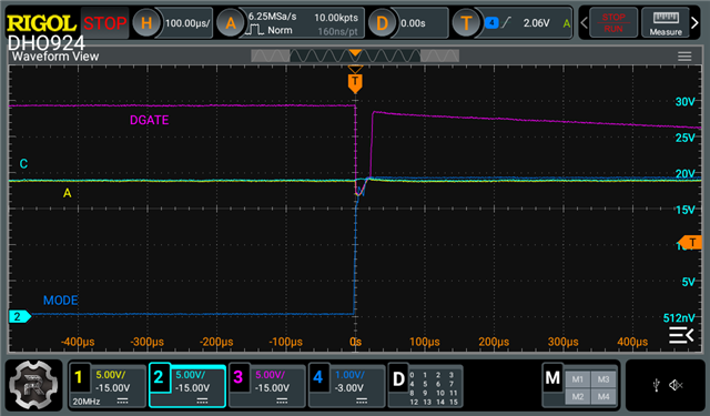

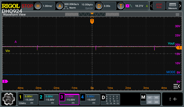

I have a strange situation with LM74930Q1EVM board.
My test system looks like this:
1. MODE is connected to VREG.
2. When Battery charger simulator is turned off, current flows from Battery simulator to Constant current load simulator. It's Ok.
3. When Battery charger simulator is turned on, current doesn't flow from it to Constant current load simulator, because of MODE pin. It's Ok.

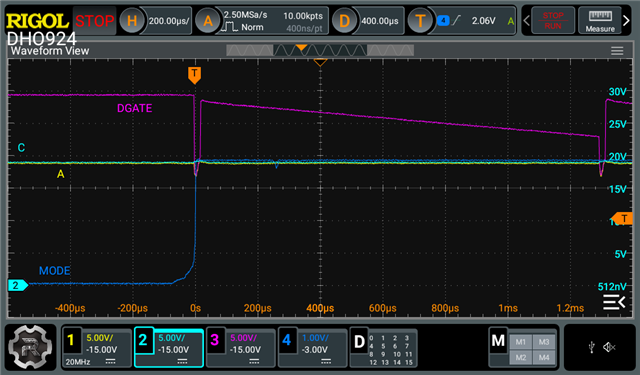

4. Then I connect MODE pin to GND to disable RCB. Current from Battery charger simulator starts to flow to Constant current load simulator. It's Ok.

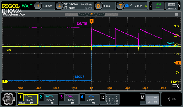

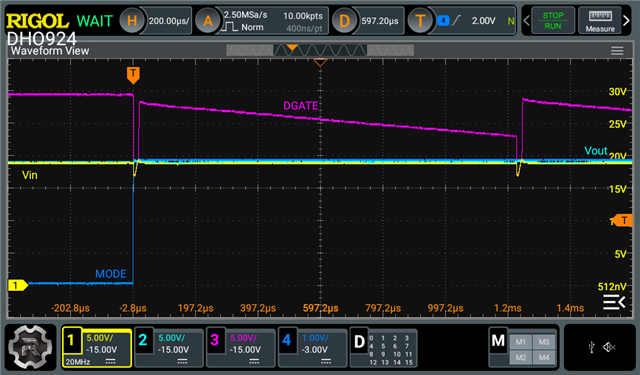

5. Then I connect back MODE pin to VREG to enable back RCB. Current from Battery charger simulator still flows to Constant current load simulator. It's NOT Ok.

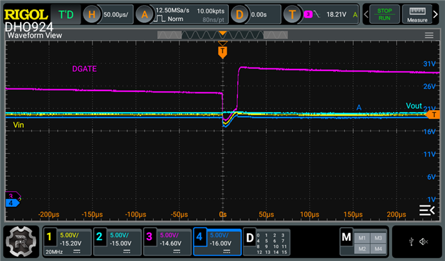

One more picture to make sure that the current flows.
Any help would be appreciated!
