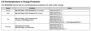

    How is the protection actually triggered? There is a setting in DA Config for min/max/avg, but this seems like it is just for reporting. Does this also affect how it is calculating thresholds internally. Or is, for example, the hottest thermistor always going to trigger overtemp?
    Each temperature protection has a specific list of conditions that need to be met before triggering. Since each temperature sensor (if enabled) needs to be deemed as a Cell Temperature reading or FET Temperature reading, based on how these are set can trigger different protections. In the protection below, this will rely on the Maximum Cell Temperature reading (since multiple can be enabled) to trigger this protection:

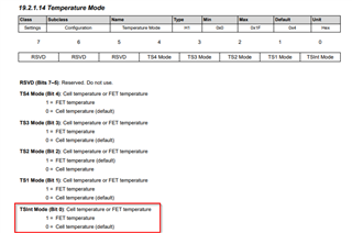

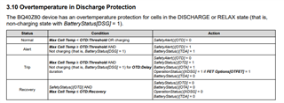

  • Thank you. I have a follow-up question. Is it possible to set different limits for tripping for each sensor? For example, we would like to limit cell temperature to 50C, but it would be fine for FETs and IC to run hotter than that. However, if we enable the internal sensor, the system will trip when it reaches 50C, but cells are still cool enough to charge. Any solution for this, or do we just have to leave Int and FET temps out of the calculation?
  • Hi Jamie,
    The temperature protections are divided into ones that are controlled by the FET labeled sensors, and ones that are controlled by the cell labeled sensors. For example, you can set the Overtemperature in Discharge protection, which is controlled by the cell labeled temperatures to 50C, but you can also set the Overtemperature FET Protection to a higher value and they will not interfere.
    Anthony
  • Thanks. Can the INT sensor be handled differently (i.e. at a higher temperature), or is it tied to the discharge temperature limit.
  • Hi Jamie,
    The internal temperature sensor will be treated as either a cell or FET temperature within the protections based on how it is set.
    Anthony
