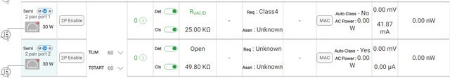

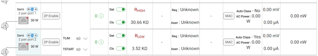

Our new prototypes, which use 6 of the 8ports of the TPS23882B work fine as long as we use Cat5e/Cat6 cables to connect the PoE ports. As soon as we connect more than one PD using shielded cable (ie. Cat6A) however the TI PSE does not detect the PD correctly in semi-auto mode.
We have purchased the TI dev boards for this product, and using the TI software that comes with the two dev boards verified the same results. If we connect one Cat6A all it good, but as soon as we connect more than one the PSE detects random PD (high, low or short resistance) and never validates detect/classification. All cables are 50ft.
