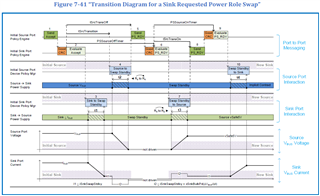

    I will explain what we see on the PD logs, in case it helps:
    And compare them to the process of a Sink Requested Power Role Swap of the standard (figure 7.41):
    OUR_PORT initially connects as Sink.
    Messages 514 and 516 are 5Amp cable validation
    Messages 518 to 521: TI_EVM_PORT (source) sends its source capabilities
    Message 523: OUR_PORT (sink) requests the 20V/5A PDO
    Message 525: TI_EVM_PORT (source) accepts the request
    Message 527: TI_EVM_PORT (source) informs that the 20V/5A PDO is ready
    Messages 529 and 531: are not relevant for the problem we are analyzing, but it is TI_EVM_PORT requesting a DRSwap and OUR_PORT rejecting it.
    Message 533: OUR_PORT (sink) requests a PRSwap
    Message 535: TI_EVM_PORT (source) accepts the PRSwap (step 1 on figure 7.41)
    Message 537: TI_EVM_PORT decreases the bus voltage to 0V (step 4), switches its Rp to Rd to become sink and sends PR_RDY (step 5) to OUR_PORT
    Message 539: we believe OUR_PORT receives the PR_RDY and switches its Rd to Rp to become source (as we see enablesource_port1(73) event is activated), but it fails raising up the bus voltage to 5V (step 7). Regardless of this, it sends the PR_RDY (step 8) to the TI_EVM_PORT, but the bus is not ready, and the ports detach.
