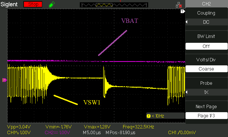

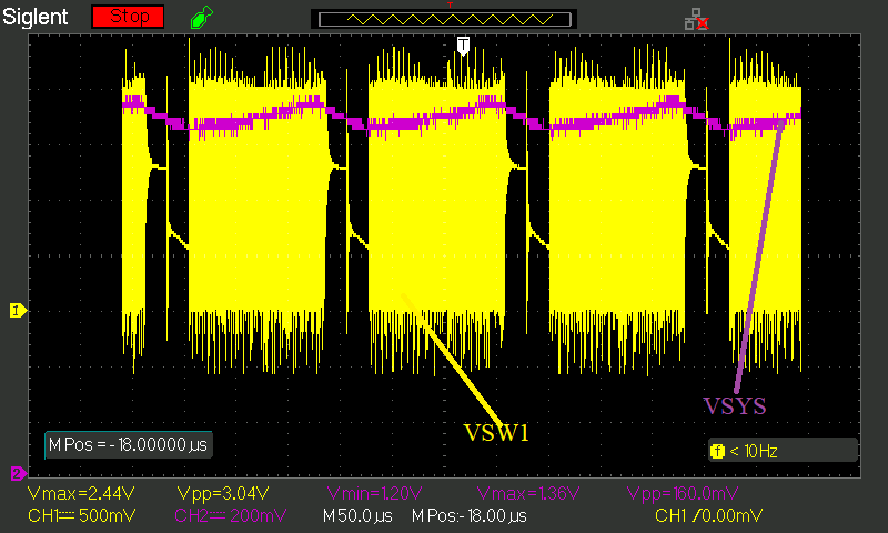

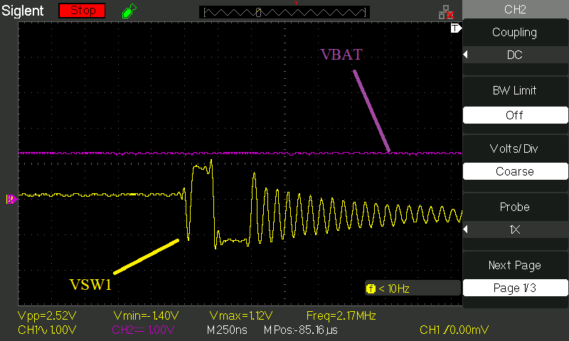

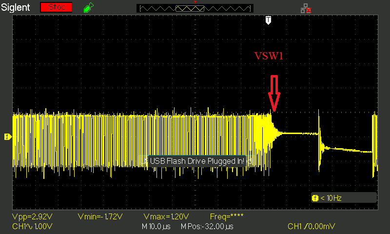

  • Here are the snaps for your reference, this is with the 47nF/25V caps

  • Hi Burhanuddin,
    I am confused by the pink trace scale.  Are BAT and SYS really down to 1.x V?  Ignoring the scale, it appears that the SYS output is hitting OVP and shutting down the converter.  Do the status and flags from 0x1B through 0x27 report OVP?

  • Hi Jeff,
    I checked and found that the Vsys voltage goes upto 13.1V (With ringing) when Battery is charging.
    In addition to that I found that there is a spike in Vsys when the battery is not connected, it last for around 14.6mS
    In addition to this, when the battery charges at lower currents, there is no noise and no ripple at Vsys.

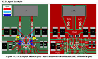

  • Hi Burhanuddin,
    On the layout, the 0.1uF and at least 1 of the 10uF caps on SYS and PMID need to be on top of the IC on same side without vias as shown below:
    The inductor and additional bulk caps can be on the other side.  Can you manually modify your board by scraping solder mask to add those components and see if that helps?

  • We already have one 0.1uF cap on top for PMID, I added extra 10uF on same layer as IC, still the same result.
    Vsys Caps are on same layer as the IC.
