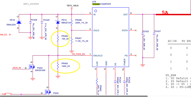

Dear Sir,

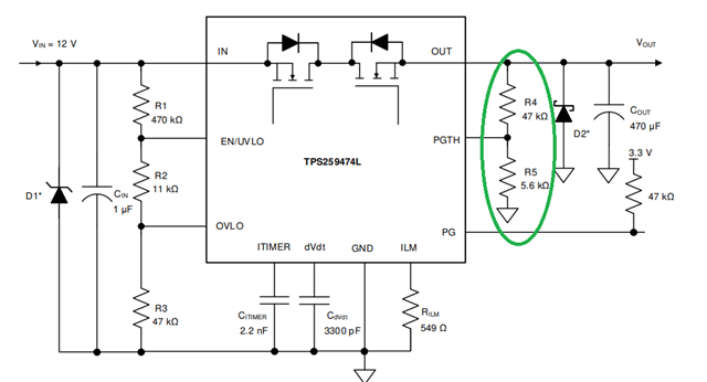

PGTH pin could be opened ?  what will happen if this pin is opened? It can cause any damage for following circuit design ?

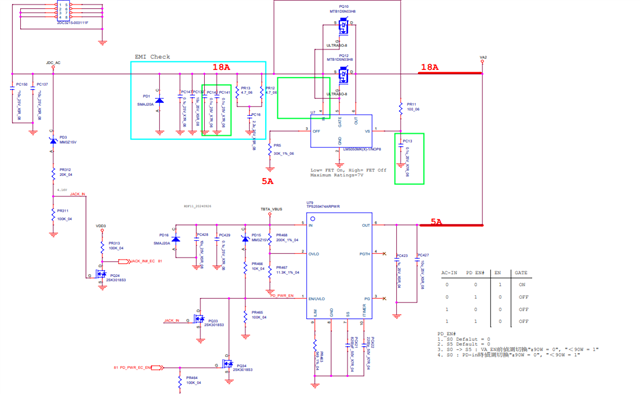

PS, When AC Adapter pug in (20V) , TPS25947 VIN PIN ; V0UT PIN ; PGTH pin , three pins are damaged.
( Only one M/B was happened )
If this pin can not let open ,  what R4&R5 values are recommend ? ( VIN 20V;  VOUT 20V)
Thanks and best regards,
Bryan
