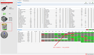

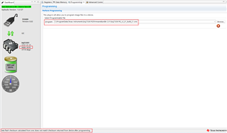

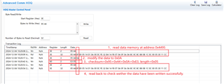

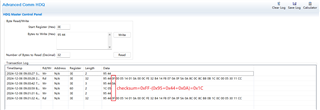

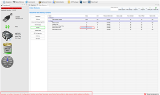

I have a problem when I use BQ27Z561, I write the Data Flash , but failed.
I can write regesiter successfully, and the [SEC1][SEC0] = 01, it's full access.
what should i do?
