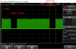

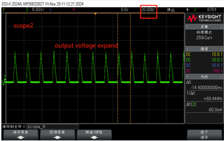

The project we designed  used the LM5143+4pcs MOSFET dual phase architecture. input=16-32V ,output voltage= 14.4V, the current max 20A. The output current can reached 12A. Schematic as attached. There is no problem we mass-produced last year.

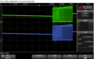

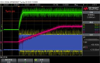

However, we recently mass-produced a batch and found that its output current capability has deteriorated,The component used is from the same batch left over from last year,the output current reached 5A the voltage not stability. please refer to the scope1 and scope2.  The result seems the loop unstable.

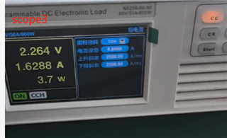

1.the Currently mass production:output current=6A begin unstable.  please refer to scope3.

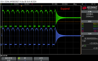

2.Change the 4pcs mosfet form the PCBA mass production last year, the output =9A begin unstable.  please refer to scope4.

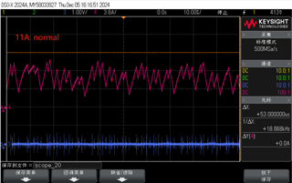

3.Populated the R65031,R65030 and C65051,C65050 can reached 12A no problem,Please refer to scope5.  however the these 4pcs resistor and caps is also depop in production last year.

    The tested socpe for your reference. (Green: Vout, Pink:SS , Yellow:SW2, Blue: SW1)
    Please confirm them.

  • Hello victor
    Thanks for sharing the waveforms. Are these waveforms taken at 12A load current? SW2 waveform looks okay however, SW1 is alternating between wide and narrow pulses. Could you probe inductor current of phase 1 to see if there any subharmonic oscitations present in the circuit?
    Onkar

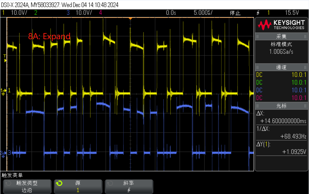

  • Hi Onkar
    The waveforms taken at 3A(light load).
    8A Load current has issue please refer the scope as below:

  • Hello Victor
    From the waveforms it looks like hiccup mode is triggered. with Cres = 220nF, t_res (hiccup delay) is around 13 ms. Non switching time in your waveforms looks pretty close to this number. Could you please probe Cres voltage along with inductor current to confirm the issue?
    Thank you

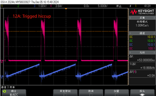

  • Hello Onkar
    It triggered hiccup mode.Please refer the scope.(Pink :Current, Blue: Vres)
    I found that although there is no problem with the 11A load, there is significant signal jitter on the Vres.
    Thank you.
    BR Victor
  • Hello Victor
    From inductor current waveforms, loop looks unstable. Could you please try testing same with following compensation values?

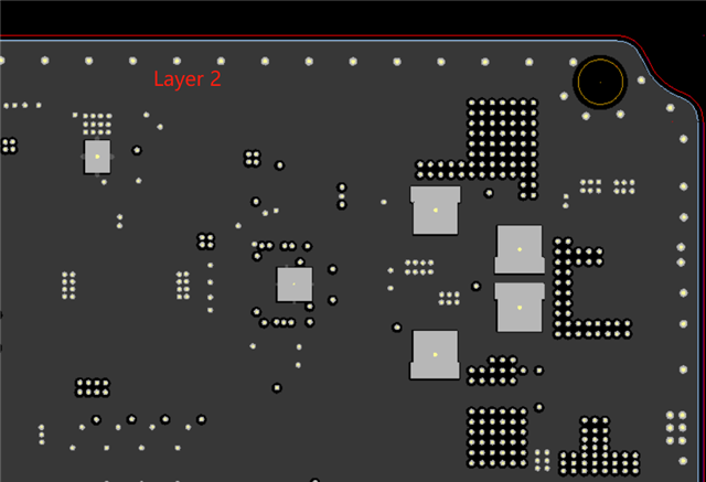

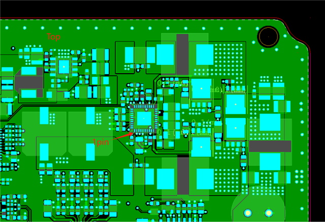

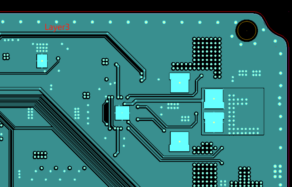

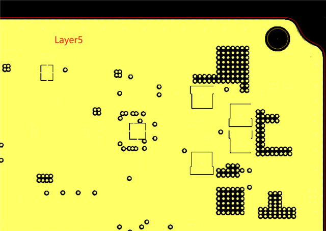

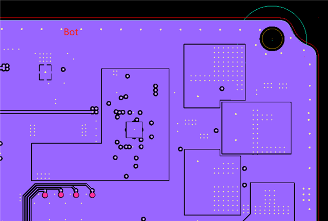

  • Hello Tim,
    Please review the layout:
    ​Thank you.
    BR Victor
  • Hi Victor,
    The switch node copper areas are quite large here and includes vias to internal layers (which disrupt the internal GND plane). In general, we recommend to minimize the SW copper area as it is a radiating plane with high dv/dt - there shouldn't be any internal SW copper area either. See app note SNVA803 for more detail. There should be a quiet GND island for AGND, especially as the controller is very close to the power stage in this design. Refer specifically to the EVM layout and the layout guidelines in the data sheet.
    Please check that the VCC caps are right beside the VCC and PGND pins. Also the boot caps should be close to the BOOT and SW pins. The EVM layout template is what should be replicated here.
    Tim
