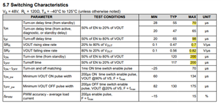

My question is:
If I want to apply 1.5kHz, which is 667us. And the duty cycle I need is 60%, then the time period of on/off would be 400us and 267us.
The Ton and Toff time in datasheet is 200us max -- in table 5.7. So the Ton/off is 200+200=400us. I suppose it is already same as the 1.5kHz 60% duty cycle ON time. Would that be a risk?
I would like to confirm if TPS1THC100 can support 1.5kHz 60% duty cycle.
Also, I would like to learn if calculate with Ton/off time is correct. or should I calculate with VOUT rising/falling slew rate?

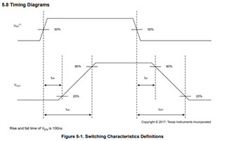

    According to the diagram below in the datasheet, the tON = tDR + SRR time and tOFF = tDF + SRF.
    However, if we wanted to calculate times using the slew rates given then:
    24V car battery, max 32V supply
    1.5kHz, total 667us for one period
    400us on, 267us off
    Note that the following calculations are done assuming max times for all and worst-case scenario.
    For turn on:
    Delay time tDR = 70us
    Slew rate SRR = 0.7V/us
    Total time for turn on = 32V / 0.7V/us + 70us = 115.7 us or worst-case tON = 200us
    115.7us (or 200us) < 400us time on
    For turn off:
    Delay time tDF = 98us
    Slew rate SRF = 0.82V/us
    Total time for turn off = 32V / 0.82V/us + 98us = 137.0 us or worst-case tOFF = 200us
    137.0 us (or 200us) <267us time off
    Note (4/22/25): I had to modify these calculations as I made a mistake with the equation. I apologize for the confusion, but the final conclusion is still the same. Please also refer to this app note for more information - Driving PWM Loads with TI High-Side Switches
    Based on these calculations, the TPS1HTC100-Q1 should be able to support a 1.5kHz 60% duty cycle.
