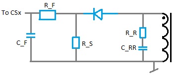

    I have:
    1:100 turns, R_R = 330R, C_RR = 22p, D = 200V/1A, R_S = 10R, R_F = 1k, C_F = 220pF. => This should give me approx. 2V at max current, which I also seems to measure - but I'd like to attenuate/clamp the ringing at turn-off - it's above 4-5V and I think it kills the CSA and CSB inputs.

    First, the BOM is NOT wrong.
    The 33V zeners are used to clamp the reset voltage on the CTs, not to clamp the signal itself.
    Second, 4-5V ringing on CSA and CSB cannot kill those inputs; they have a +7V Abs Max rating.
    But they should not have any input voltage go below GND.
    However, significant ringing after turn-off may be indicative of a different problem.
    Since you says  “D = 200V/1A”, this suggests you are using a power diode to rectify the CT output.
    This kind of diode is too big, and has too much reverse recovery and junction capacitance.
    You should be using a signal diode (typically 4ns trr and ~4pF) as listed in the BOM.
    You have got some parts whose purpose I can’t identify: R_R and C_RR are mysteries to me.
    R_S is the sense resistor at 10R, and I believe R_F and C_F form an R-C filter to the CSx inputs.
    These sound okay, provided the 220ns time constant does not significantly degrade the CSx waveform.
    What are the R_R and C_RR  for… Do you really need them?
    Third, I think you should use a higher value R_S.  A 2-V peak at maximum current is underutilizing the capability of the multiplier range.
    It is good for 3.6V and I recommend that you use all of it.  This suggests a value of 18R.
    (Changing this may require changing some other resistor values as well, to match the scaling.)
    If the CSx signal exceeds 3.6V, it will not clip internally, but kind of has a soft non-linear compression above 3.6V.
    You get a little distortion, but not much even up to 4V input and then it starts to flatten out more rapidly.

    R_R and C_RR is the resistor and capacitor of my reset network of the current transformer. They are in series and are coupled from "+" on current sense trafo to "-".
    I'll try to change the diode to a 1N4148 200mA 75V 4ns and see if that dampens the ringing.
    The currently diode is 15ns STTH1R02 (Farnell 1295245).
