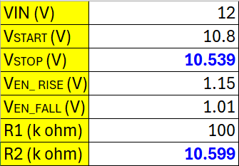

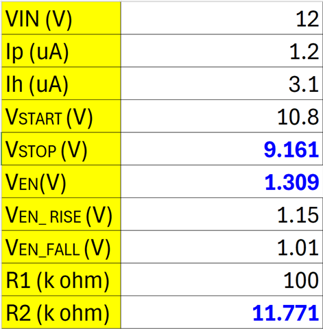

Hi Team,
Q1. What are VEN(R) and VEN(F)?
According to section 6.5 (Electrical Characteristics) of the TPS562211 datasheet:
VEN(R)=1.15V
VEN(F)=1.01V
Section 7.3.6
VEN_FALL=1.15V
VEN_RISE=1.01V
Q1.1. Is the VEN_RISE the same as VEN(R)?
Q1.2. Is the VEN_FALL the same as VEN(F)?
Q2. If the VIN(normal) =12V and I want to design the enable rising threshold in VIN=10.8V:
       When I use external R1 and R2 resistor to set the EN on/off threshold, is the follow table correct?
