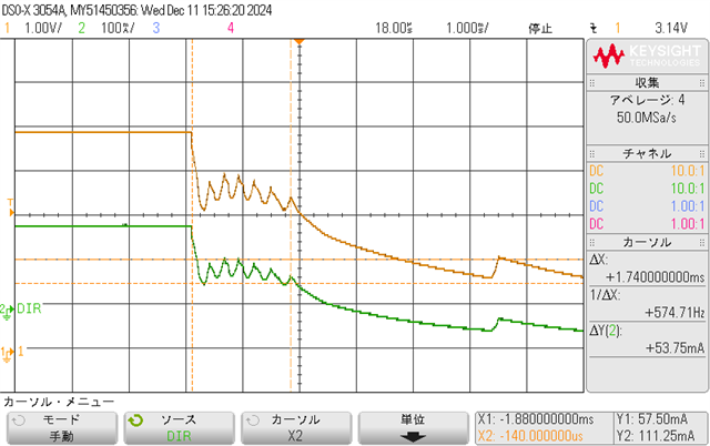

I want to know why this vibration happening.
I think the value of the capacitor of filter is the cause.
The value of the capacitor is 0.1uF.
Please tell me.
Please tell me.

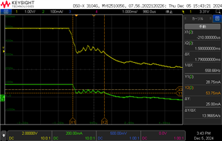

Looking at the the waveform you had provided, I am assuming that the yellow waveform is the 5V VDD signal, where is the green signal getting probed?
Since it is the VDD signal, have you tried depopulating the TPS3702 to see if the oscillation is still present? I am asking because the ringing at power down is not a documented behavior of this device.
Jesse
The waveform of yellow line is the 5V VDD signal.

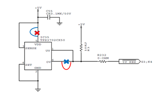

The waveform of green line is the current measured at the blue line in attached image.
Sorry,we have not tried depopulating the TPS3702 to see.
It oscillates after TPS3702(measured at red line in attached image), but not before TPS3702(measured at blue line in attached image).
So, we think the TPS3702 is the cause of oscillation.
Okay, since the oscillation is detected on the output of the TPS3702, could you please remove the R232 and test again?

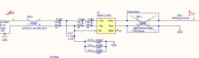

Is this test done on the EVM or a different board?
How is the board/device powered?

You might want to remove the C55. The decoupling capacitor in combination with the ferrite bead might be causing the issue.
Jesse
I removed C55 and performed the measurement.
But oscillation is still present.
The 5V is generated on a separate board and supplied to the reset IC through a switch circuit.
Therefore, C55 in combination with the ferrite bead might be unrelated.
I apologize for the lack of information.
My concern is that there is something on your design that is behaving like a low pass filter and preventing the quick transition of the reset assertion. By removing the power supply as the root cause we can troubleshoot another part.
