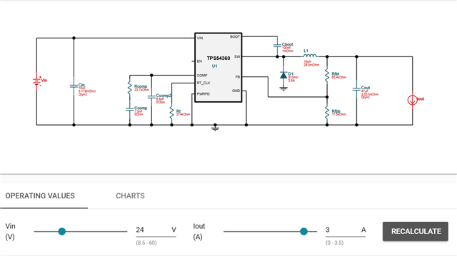

Could you please confirm if this component support load Dump (overvoltage)? I would provide the power from Electrical Vehicle EV (24V).
should I need TVS diode (28v) to protect my circuit ?

TPS54360 is rated for Vin = 60V. However, according to the profile for unsuppressed load dump, the peak voltage could reach as high as 202V. To address this, you'll need a circuit to suppress the transient if it is not already implemented in overall system. You can either use a TVS diode or consider the circuit suggested in the https://www.ti.com/lit/ab/snoaaa1/snoaaa1.pdf?ts=1733243809532&ref_url=https%253A%252F%252Fwww.google.com%252F.
I hope this answers your question. Let me know if need further clarification or assistance.
