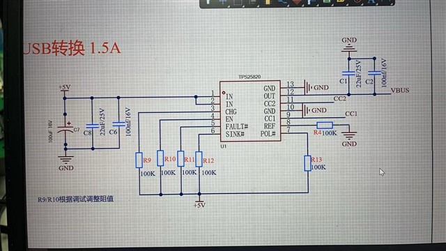

TPS25820: Circuit design, current output can't reach
Part Number: TPS25820

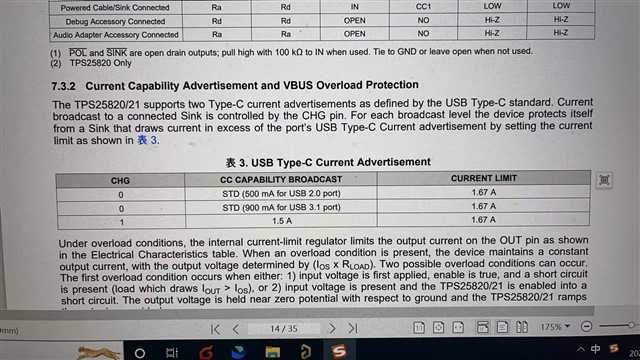

The customer circuit design is as follows, but only about 900m output current, measured whether the CHG end is 5V high level, not connected to 100k direct pull-up test, or only 900mA output.
Please help to see if there is any problem with the design, thank you ~
