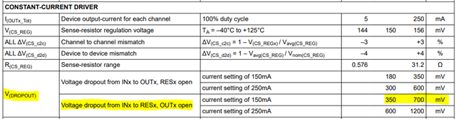

  • Hi Shunsuke-san,
    The TPS92620-Q1 thermal sharing operation works by applying as much current as possible through the RESx pin, and the remaining current through the OUTx pin. This means that the RESx pin operates at the dropout voltage of the internal constant-current regulator.
    The exact dropout voltage depends on the operating conditions and varies from part-to-part. For this example I selected 400mV as a reasonable value.
