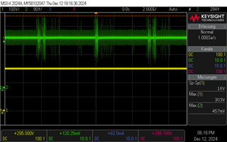

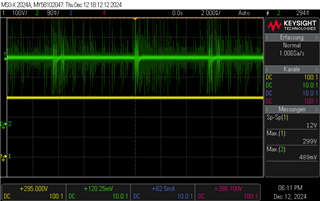

    Here first screens of COMP
    and Vref pin

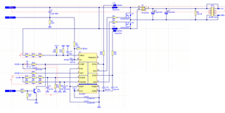

    The last time I checked the Vref, it was 6v. I recognized all modified boards have broken Vref after short period of time. In the datasheet is mentioned, that it can drive 1mA. The load is calculated less than 0,1mA. My modificated board is alinged to the demoboard and the PHB pin is Vref/phb/gnd connected with 220k/47k. (and Vref/brst/gnd is 180k/18k) Vref/GND R= 94,4kOhms
    For now, I measured the PF of the 28064 Demoboard and it is 0.88 without load. But indeed, it has way small capacitors.
    Regards Sascha

  • Hello Sascha,
    Nothing will work if VREF is only 120mV.  According to your schematic diagram and PHB and BRST modifications, the loading on VREF is minor.
    If VCC is in spec (>13.5V to start-up) then VREF should be in spec (= 6V).   Please check your VCC, then VREF.
    If VCC is okay and VREF is still near 0V, then something is pulling it down, despite what the schematic says.
    It could be a damaged controller (maybe from ESD?), or a damaged ceramic filter cap, a solder blob to GND, or some other cause. You'll have to find that problem and remove it.
    You mentioned that all modified boards "have broken VREF after a short period of time".   Does that mean that VREF was working in spec for a while, then failed?  How long of a time?  Maybe something is systematically over stressing it.  Check the PCB to make sure that the layout matches the schematic.

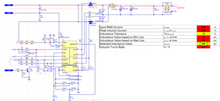

  • Hi Ulrich,
    so far there is no solution for the modification of the pcb, so I decided to design a new pcb with ucc28065.
    I changed the schematic like in sluc697 mentioned. The coils are still 260uH, I’m in research to find proper coils. Is there a standard shielded coil for 28065?
    How will R9 effect the behaviour of the PFC? How do I setup C13/14?
  • Hello Sascha,
    I hope your new pcb design will not have any of the problems that the old pcb has.
    Please follow this pcb layout guideline App-note to minimize possible issues:  https://www.ti.com/lit/pdf/slua959
    There is no standard coil for the UCC28065 (or for most other controllers) because everybody's design is different; different inputs and outputs and power levels, etc.  The inductors are usually custom-designed, unless you find a stock device which fits to your requirements by luck.
    R9 in parallel with R13 on the VINAC input will modify the divider ratio of the VINAC sensing which will affect the gain levels of the internal feedforward circuit.
    Please follow the Excel calculator recommendations for VINAC resistor-divider values.
    C13 and C14 on the ZCDx inputs provide a time delay to the ZCDx signals so that optimal valley-switching can be obtained to minimize turn-on losses at high line. The values for C13 and C14 should be tuned up or down empirically during prototype evaluation to set the turn-on of the MOSFEts at the minimum valley voltage of Vds.  Czcd too low turns the MOSFETs on too soon. Czcd to high turns the MOSFETs on too late.  Both too soon and too late will increase switching losses in the MOSFETs.  See Section 8.3.4 (page 17) in the UCC28065 datasheet.
    In the future, please provide the name of the pin to which the component you reference (R9, C13, C14) is associated, so I don't have to hunt all over the schematic diagram to find them.
