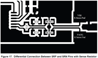

    I do have a follow up question regarding the connection of the two ground paths.
    I want to connect the grounds with a 0 Ohm resistor. As I understand the datasheet, the connection should be placed close to the current sense resistor.
    My question would be:
    to which terminal of the sense resistor should I connect the ground connection?
    the datasheet of BQ35100 shows a connection between GND and BAT- (below picture)
    the EVM of the BQ35100 shows a connection between GND and PACK- (picture below)
    I do believe that the labeling in the datasheet is wrong and that I should connect GND and PACK-
    What do you think?
    Max
  • Hi Max,
    I believe that the 0 Ohm resistor should be places between GND and PACK- based on the EVM.
    Regards.
    Anthony
