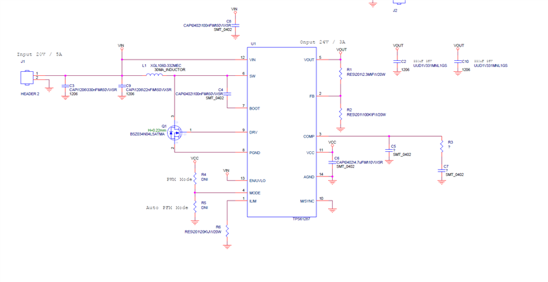

Does there have any caculator tool for TPS61287 compensation can share to us?
Or have any suggest value for Vin 20V to Vout 24V/3A?
Please help review below schematic for  Vin 20V to Vout 24V/3A application.
Thanks!
Jeff

    1. Please add some ceramic capacitors to the output side.
    2. the compensation parameters can be choose as: Rcomp=40k,Ccomp=47nF,and Cp=100pF;
    Could you share the EE of this case?
    Fergus

  • Hi Jeff,
    Thanks for rapid response.
    For the Layout, it is not optimized but acceptable.
    The AGND could be disturbed by PGND switching noise.
    I guess this will not lead to device damage.
    Could you check if the device is working normally with lower input and output target?
    Switching spec could be tested at lower voltage.
    Also please tell me if there are more findings like oscillation or unstable.
    Fergus

    I've get the board and try to provide Vin =12V. First time is fine can provide 25V output.
    SW pin waveform seem fine, but I don't save the waveform.
    And 2nd time I add load about 200mA then Vin also short to GND.
    I'm trying to apply sample and EVM for double check.
    I have question about the FB resistor, I found we using 2.4Mohm and 100kohm, but we found datasheet using 2xxkohm and 1xkohm,
    Is it impact IC normal work?
    Thanks!
    Jeff
  • Hi Jeff,
    theoretically, the FB resistors only influence the output voltage target.
    The main question is about the burn issue.
    From former information, one is Vin short to Vout and another is Vin short to GND,
    This reflects that the upper or down MOS have been burned.
    One possible reason is shooting through.
    Please compare the switching & driving waveforms of the EVM and your board to see the difference.
    Would you mind send me a board and we can do the same test with you?
    Please keep me informed if you have any update.
    Fergus
