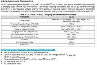

  • Hello Murilo,
    1.
    Is there anything else that needs to be checked or configured to initiate charging?
    Here's the requirements for the device to start charging:
    2. Can you measure the voltages on VAC, VBAT and REGN?
    3.
    What are the conditions required for REGN to generate voltage?
    Here are the conditions for REGN to turn ON:
    4. Yes, the CE pin needs to remain LOW to charge. A pulse will not work.

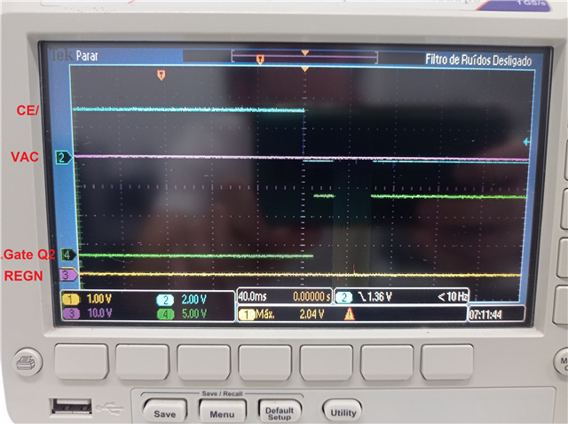

    Ok, I’ll take this opportunity to share a few more observations:
    Attached is an image captured via oscilloscope showing the input voltage (purple), CE/ pin (blue), Gate on the MOSFET Q2 of the reference (LODRV1), and REGN. Notice that when enabling charging by pulling CE/ to LOW, the REGN remains disabled, while the gate of Q2 is enabled. Could the gate being enabled even with REGN at 0V indicate an error, or is this behavior expected? If it is an error, what could be the possible issue and the potential solution?

  • Hello Murilo,
    I'm glad to hear REGN is working now.
    In this case, what behavior should I expect? I understand it’s in trickle charge mode, but I’m unsure about the expected voltage and duration during this phase. Could the observed value be correct?
    I would expect the output voltage to rise up to the battery charging voltage (58.4V) here. Can you measure the voltage on VBAT and VFB? (To measure VFB, I'd recommend disabling charging, putting the probes on VFB, and then enabling charge again)
    What do the status and flag registers say?
    Since I’m adjusting the registers for a 2A battery, I also changed EN_PFM=0 and set ITERM to 250mA (the closest value to 10% of the charging current). Are these changes necessary? Are these values appropriate? Is there any other register I need to adjust
    Yes, these registers are appropriate. The hardware setting will also set the termination current to 10% of the charge current by default. So, you don't need to set ITERM.
    Considering that the battery to be tested is nearly fully charged (around 54V), what behavior should I expect in terms of output and input readings and the duration of the process? Do I need to define the duration of each charging stage via software?
    You should expect the charger to enter into fast charge mode and then transition to taper charge once the VFB voltage reaches VFB_REG, 1.536V by default. The battery voltage equals the charge voltage here.
    The charging stages are based off of the voltage of the battery. So, you don't need define the duration of each stage.

    6.1. Yes, only Q2 (yellow) and Q4 (blue) are switching, while Q1 (purple) and Q3 (green) are not switching correctly, as can be seen in "attachment6.1".
    6.2. In "attachment6.2", the waveform for SW1 (blue) and SW2 (purple) is shown compared to the gate of Q2 (yellow).
    6.3. In "attachment6.3", the VFB (blue) and VBAT (purple) are shown compared to the gate of Q2 (yellow). Unlike the previous tests that were done with no load, in this test, both the input and output were supplied with approximately 43V.
    6.4. The IC has been reflowed and it has been confirmed that all the pins are properly connected.
            7. It is observed that the capacitors C1 and C2 are not charging, which seems to be influencing the ramp waveform (instead of a square one) on the gates. What could be the cause of this, and what is a possible solution?

    The new layout has been designed incorporating the suggested changes. Progress has been made, as capacitor C2 is now charging; however, the gate of switch Q1 is not switching—it remains at a constant high voltage—causing a short circuit and resulting in Q1 burning out (while the other switches are operating correctly).
    It has been considered that the IC might not be functioning properly, although I find this possibility unlikely.
    What do you suggest could be causing the malfunction? Additionally, what further tests can be conducted to diagnose the issue?
  • Hello Murilo,
    That is strange. Why would Q1 be high all the time?
    I've got a few questions to help us debug this:
    • What voltages does this problem occur at?
    • Do you see a difference in the behavior if you go to an inductor with a higher DCR? 11mΩ would be optimal to test. This is same DCR that the EVM has.
    • Have you performed an ABA swap on the IC to see if the behavior follows the IC or the board?
    • Can you send me your updated layout?
    Ethan Galloway
  • Hi Ethan,
    The IC has been replaced, but testing has not yet been performed, so I am unable to provide an update at this time. The inductor issue is also under investigation.
