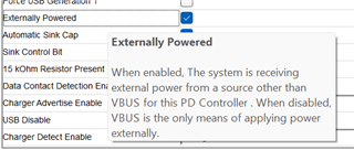

  • Hi Martin,
    Thank you for reaching out!
    Here are a couple suggestions that may help:
    1-Since this is a source-only application, the port configuration in register 28h should be set to "DFP"
    2- Since this is a UFP, Data Capable as USB Device should be enabled, and Data Capable as USB Host should be disabled.
    Please let me know if the following changes have an impact on the observed behavior.

  • Hi Aya,
    I tried your changes, but still same behavior. After plugging TH3P4 riser the macbook start reporting 15W charging.
    Any suggestions, please?

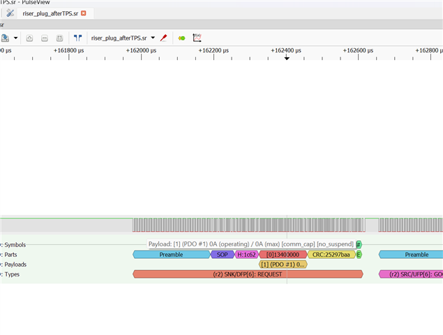

    I have an update. I did PD communication decoding.
    Please, download the PulseView from provided website to be able check my measurement - https://sigrok.org/wiki/Downloads
    After downloading and installing, open attached files in PulseView. With scroll on mouse you can easily zoom and check the decoded values.
    Picture for preview how decoded data looks.

  • riser_plug_afterTPS.srTPS65987D was connected first. Than I plugged TH3P4 Lite riser to the Macbook. The data in file show only what happened after the Riser was connected. (Before the Riser connection the decoded data looked like in TPS_plug.sr.)
    If I am understanding these logs, I think I found the issue. Please correct the assumption below:
    The riser_plug_afterTPS.sr - This is a PD connection between the TPS65987 and the Macbook. If this is true, then the problem is the macbook changing the PDO contract from 20V/4.7A in the TPS_plug.sr logs to 5V/0A when the riser is plugged in:
    If this is the case, this is the macbook deciding to change the PDO which seems odd but maybe the macbook favors to power over one port more than the other?
  • HI Christodulos,
    You are right. I understand it same. I am so confused about this.
    Also, you mention that you found a issue... Do you have any solution how to fix it?

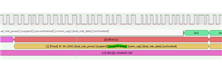

  • Martin,
    Much more clear! Thank you.
    I plugged TPS65987 first, mac start reporting 100W, then I plugged 65W USB-C charger. After charger was connected macbook start reporting 65W and TPS got 5Vout request from macbook.
    The problem is the Macbook is driving this. Not the TPS65987. The TPS65987 is NOT reducing the advertised PDOs. When the second device is plugged in, the Macbook is driving the renegotiation on the TPS port each time. In both the Dell Dock and the 65W charger there is a renegotiation to 5V/0A PDO with the TPS65987
    65W Charger:
    Dell Dock:
    Note these requests are coming from the Macbook which controls the source contracts. The Source can advertise 100W, if the sink (Macbook) does not request it, source (TPS65987) cannot provide it.
    TPS65987 is doing all things correctly, the Macbook is doing something odd and deciding to change power contracts based on the latest connection, not highest power. There are no config changes that could help resolve this but I may have some suggestions to try:
    • Connect the 65W charger first, then the TPS65987. If the Macbook is behaving like I suspect, the TPS65987 contract will be providing power.
    • Another option could be to send the 4CC command 'SSrC' - Send Source Capabilities AFTER the other device is connected. This may get the Macbook to renegotiate with the TPS for the higher power.

    I think I may have found the potential issue. In the first PDO there is an option for Unconstrained to be set or not. For the TPS65987 the initial PDO does NOT have this bit set:
    However from the Dell Dock and 65W Charger, this bit is set:
    I think this is our issue as the Macbook is seeing this bit NOT set by the TPS65987 and preferring the other devices because not setting this bit causes the Macbook to think the TPS65987 is running off some finite power source and cannot supply the source power indefinitely.
    We can fix this I believe by setting the 'Externally Powered' bit in Port Control (0x29):
    I cannot save the PJT at this time but please try this out! If it does not provide better results, then we will need to do your suggestion of capturing both ports and VBUS (is possible)
  • Hi Chis,
    You solved my problem! It is working now. Many thanks! This is my Christmas present :D
    I am going to test it in next days, and let you know if I notice some non-standard behavior.
    Enjoy the holidays, take a rest!
    Thank you very much once again!
    Martin
