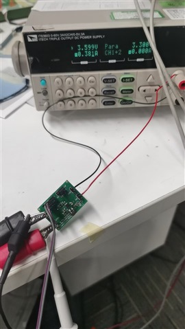

Hi Tier
My customer get one TPS63000EVM-148 to test our chip.
But customer find that the EVM can not output current when load > 200mA. Then the output voltage will reduce.
Could you give me some suggestion?
Thank you very much.
