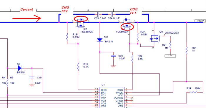

Current flow in CHG & DSG Fet in Bq20z95
In Bq20z95, there are two fets on high side -> CHG & DSG. As it can see in below image:
During discharging, (when both CHG & DSG fet are on), current flows in direction as I have indicate by red arrow
My question is, when current flows it will pass through diode of CHG FET & Channel of DSG FET. But why there is no drop of voltage caused by diode in CHG FET (0.7V typically). When i/p voltage is 14V, I get 13.8V at o/p.
