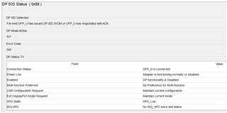

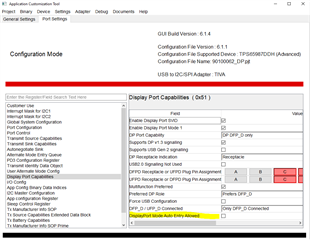

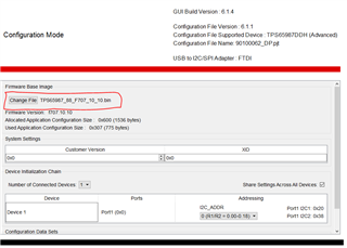

I have a custom TPS65987D/TUSB1146 system that is working in all aspects except for I cannot get the DP mode to work.

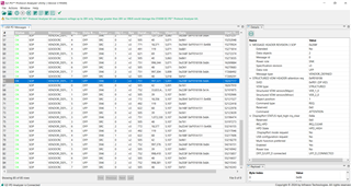

This system uses a Xilinx SoC and is a DFP for USB3 and DP. All USB and PD3.0 functionality works well but I cannot get DP to engage. I am using the TUSB1146 in GPIO mode. I can see successful DP events and even see HPD high on the DP Rx but I can never get the HPD signal from the PD controller to the mux to go high. Below is screenshot from the DP SID status debug. Attached are my project and debug snapshot. Please help!90100062_DP.pjtDP_debug.zip
