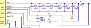

Hi Ti team
I have designed the circuit based on Webench.
I would like to request your review.
please note that the components I used are in millimeter units.
I have a few questions:

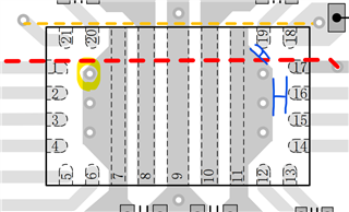

  1. Is it necessary to separate AGND? Does AGND apply only to analog components?
    • I am using audio, but the distance is over 50mm.
  2. Are the BOM components of the EVB in inch units?
  3. Can I use 0.5mm vias under TPS?
  4. For the blue line shown in the picture, how much spacing is recommended?
Thank you for your assistance.
TPS55289RYQR.pdf
Regards.
Jeong.

  • Hi Jeong,
    Can you mark the value and rated voltage for each part? I cannot find some of the part number.
    Can you provide datasheet of the output caps?
    What is the input voltage range? Is output rnage 5-9V, 3A? Is this a PD application?
    Usually we don't recommend to use tantalum capacitor because of large ESR. Do you consider to use a hybrid capacitor?
    Mulin

  • Hi Yongki,
    1.Make sure SCK and SDA are pulled up.
    2.MODE pin and COMP pin connection are wrong. Connect R10958 and R10962 to MODE pin. Connect compensation network to COMP pin. Recommend to to add a cap parallel to C10314 and R10961.
    3. Add RC filter between ISN and ISP.
    4.Add RC snubber in SW1 and SW2.
    Yes, recommend to use separate AGND. Only for signal pins of TPS55289. Please refer to layout guideline.
    4201.TPS55289 Layout Guideline.pdf
    Yes.  The left column.
    For reference, EVM use 0.4572mm diameter and 0.2mm for hole size. 0.5mm is ok.
    For reference, EVM use 0.2286mm distance.
    Mulin

  • Hi Jeong,
    Recommended compensation parameters: 10k+22nF parallel to 2.2nF.
    RC snubber is recommended for reducing SW spike and improve EMI performance. Recommend to reserve position.
    PD reference design: https://www.ti.com/tool/TIDA-010248 and  https://www.ti.com/tool/PMP40801
    You don't need to connect AGND of TPS55289 and PD controller. Just connect AGND of each part separately. Please refer to layout guideline above,
    Mulin
