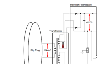

Customer wants to replace this diode-based rectification to synchronous rectification:
The input is 264VAC peak having frequency 30Khz +-12kHz. The input is square waveform.
Do you think the UCC21540 can be used? Or can you suggest other dual channel gate driver according to these requirements?
Thank you.
