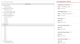

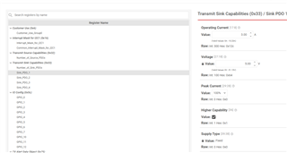

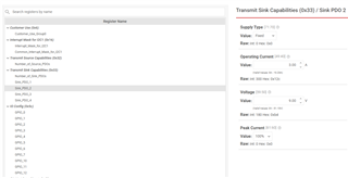

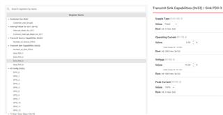

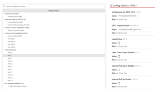

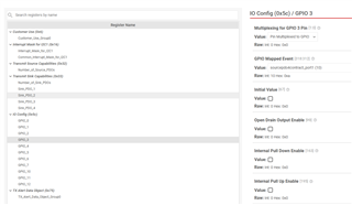

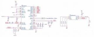

PD 充电协议和 GPIO 设置如图所示。TPS25750 以固定的 20V 电压与充电器通信,但所有四个 GPIO 输出都设置为低电压。应该如何解决这个问题?
Can you elaborate on the specific issue with the GPIO pins?
Thanks and Regards,
Raymond Lin
According to the setting, the GPIO should be set to high level after the communication protocol is successfully established. However, after the TPS25750 communicates with the charger at a fixed 20V, all GPIO pins are at low level and do not rise.
Can you also provide the JSON file you used for your application? I'll try to re-create your setup on my end using TPS25750EVM and see if the issue is replicable.
