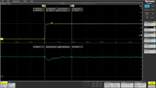

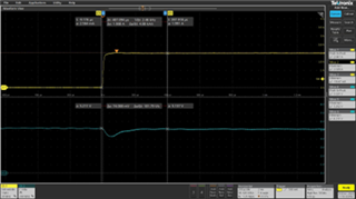

We are facing issue at the transient load response of TPS54340. From transition of output load current from 0A to 2A. The output of TPS54340 dropping from 5V to 4.2V.
Can you suggest any solution. This is the continue design we are using from a while.

-- Condition : Vin 24V, Vout : 5V, transient load current : 0A to 2A.
observed waveform as below
Virendra

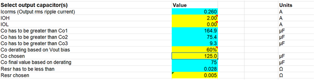

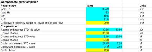

    Could you please fill the QuickStart available for the device. You can find it here SLVC452 Calculation tool | TI.com.
    Thank you
    Onkar
  • Hii Onkar,
    I have attached the sheet and below is the Section of schematic for reference,
    Also I have tested this circuit with Cout : 132 uF and 176 uF but same behavior is there.
    Virendra
    1050.TPS54360-361FAMILY_CALC_TOOL_REVE.xls

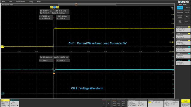

  • Hiii Onkar,
    Thank you for your response.

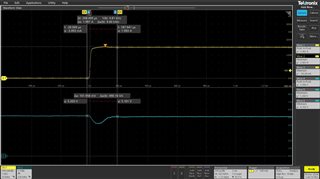

    Observed the same behavior at crossover frequencies 20khz and 40khz apx.
    1. For 0 to 2 A transient load à output voltage dropped from 5.3V to 4.240V the drop is 1.06V
    2. Observed Waveform:
             3.  Checked at crossover frequency : 20 khz and 40 khz referred below section for component values
    Due to a voltage drop of about 1V during a 0 to 2A transient load, causing the further circuit to restart.
    To avoid this, we need to reduce this undershoot to 0.1V, i.e., 1% to 2%.
     Is it possible with TPS54340 ?
    regards,
    Virendra Sutar

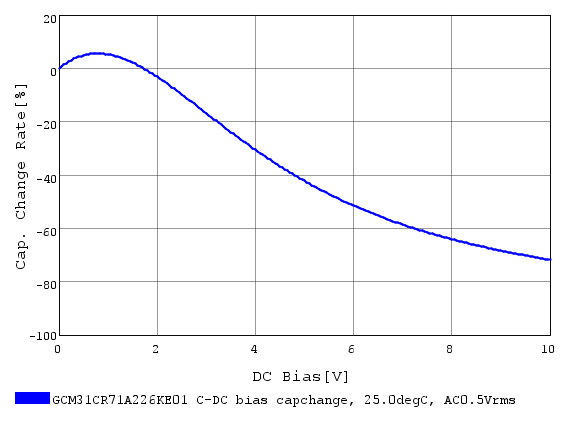

    1 - 2 % is pretty tight but should be possible with TPS54340. To get 1% undershoot you would need to output capacitance more than 85 uF. Considering the derating with DC bias, value of required capacitor will be more than 125 uF.
    Here I have considered a 22uF, 10V, X7R capacitor from Murata for derating calculation and following is the typical derating curve for it.
    To satisfy the ripple requirement you will need even higher capacitance. I would recommend you recalculate the required output capacitance and chose the combination of capacitor accordingly. Moreover, recalculate the compensation component as those will change with capacitance value.

    I have already tested the circuit with Cout = 132uF and 176uF (22uF in parallel combination)
    I have calculated the values by considering below formula from datasheet and parameters
    And Compensation values as in below schematic
    But getting same response.(L4 removed)

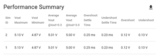

  • Hii Onkar,

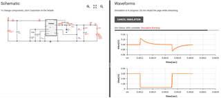

    Can you suggest component values for required transient response, with considering current schematic, it will be very helpful
    I have also checked in WEBENCH Tools
    regards,
    Virendra

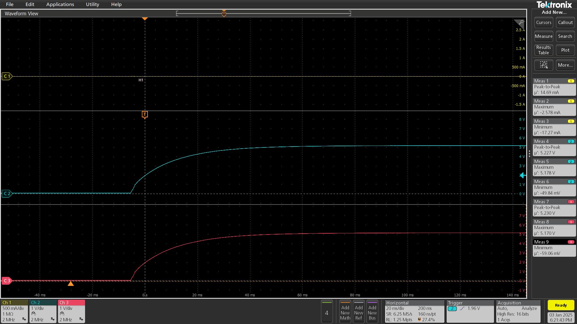

  • Hello Onkar,
    sorry for delay in response.
    as per suggestions checked the circuit and below are the observations:
    -Condition 1: Fixed capacitor at 220uF cap, (L4 Short) and Cff 1nf and 0.22uF
    -observation:
    1. in this case, 0 to 5V start up time is more
    2. behavior at transient load 0 to 1 A
    result : no improvement
    -Condition 2: Fixed capacitor at 220uF cap, (L4 Short) and Ccomp : 2nF, Ccomp 2 : 10pF: 30Kohm, (also tried different combination for Comp section)
    -observation: At 0 to 2A transient response. observed drop is 5.235V to 4.771V i.e. 0.464V
    result : Initially at transient response drop was apx. 1V but now it is 0.464V but still not achieved expected drop i.e. 0.100V
    regards,
    Virendra
  • Hello Virendra
    Thanks for sharing the waveforms!
    What is the Cff value for improved transient response?
    Moreover, could you please try applying load step after ensuring there is minimum load present on the converter before. Under no load conditions converter will be operating in pulse skipping and response of converter will be slower. Additionally output of converter will sitting at higher value than nominal value under typical load condition thus you would see higher dip during load transients.
    Try implementing this -
    Instead of giving load step of 0 to 2A. give load step of 0.05 A to 2A
    Moreover, could please point out the measurement location for Vout? layout and setup picture will be helpful here.
    Thank you
    Onkar
  • Following are the comments and questions on Waveform 1 and 2
    1. Most likely part is operating under current limit due to large output capacitor. Thus, startup time is higher than expected soft start time.
    2. Output doesn't recover in the 2nd waveform. Is it measured at the load end or right across the output capacitor?
