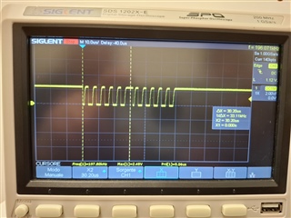

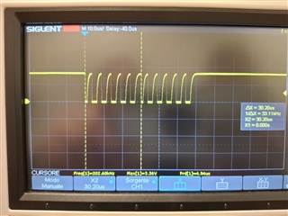

  • Hi Adrian,
    thanks again for your suggestion, we did as requested.
    We measured the signal for a not-working device and for a working one.
    The CLOCK signal is essentially the same for both.
    However, the SDA is quite different:
    WORKING DEVICE
    Working device
    NOT-WORKING DEVICE
    NOT WORKING
    As you can see, the latter has a rising curve much slower (rise time approx 1000ns).
    Furthermore, the working one has anyway a rise time of 500ns, which is over the maximum allowed by specifications (300ns).
    So I guess this is it.
    Still, I don't understand why, in some cases, removing the battery and putting it back again solves the problem.
    If you have any other remarks I'll be glad to read it.
    Thanks again for your support.
