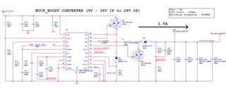

Hello Team,
The Buck-Boost converter output becomes unstable after 3 to 6 hours of operation under power-on conditions at 55°C.
Please see the attached schematic.
The Buck-Boost converter output becomes unstable after 3 to 6 hours of operation at 55°C, even though it continuously restarts.
Please provide solution and suggestions...

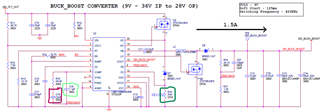

  • Hi Stefan,
    The details have been highlighted on the schematic:
    C18=1uF, C16=10nF and Kelvin R18=18 to 20 mΩ
    Thanks & Regards
    Thirupathi T

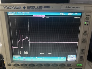

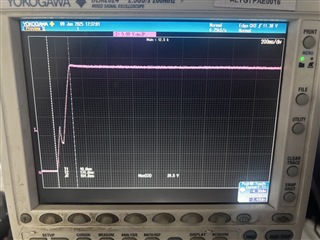

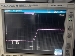

  • Hi Stefan,
    Please find the below attached images.
    1. SS
  • 3. Output waveform:
  • Hi Thirupathi,
    The waveform does not show the instability you have mentioned. So i assume that this is in normal operation condition.
    It also shows that in the startup phase there is an additional restart. So it looks like the softstart time is selected to short or the over current limit has not enough margin.
    Another reason would be that the input supply does dip in that phase.
     Stefan
