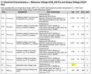

I want to generate 5.7V output voltage using TPS55162 which can adjust output voltage between 5.7V and 9V.
But, how much tolerance will there be when generating 5.7Vout?
Is there a way to calculate output voltage in ADJUSTABLE circuit?
