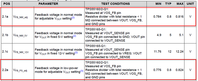

want to generate 5.7V output voltage using TPS55162 which can adjust output voltage between 5.7V and 9V.
But, how much tolerance will there be when generating 5.7Vout?
Is there a way to calculate output voltage in ADJUSTABLE circuit?

    1. May I know what is the application here?
    2. How would you use the ADJUSTABLE circuit? Currently, we have release the buck-boost converter with I2C interface, so the customer can program the output voltage with I2C command which is more convenient.
    3. For TPS55162-Q1, the internal reference voltage accuracy is as shown below.
