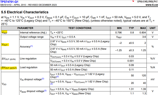

Hi TI Expert,
Could you teach me how to calculate the actual output based on following condition after considering following parameter?
Scenario 1:
  • VIN: 3.3V
  • VOUT: 1.2V
  • VBIAS: 5V
  • IOUT: 250mA
Scenario 2:
  • VIN: 5V
  • VOUT: 1.8V
  • VBIAS: 5V
  • IOUT: 100mA
ex: VREF/VOUT accuracy/Load regulation.....etc.
  • Hi Evan,
    Sorry for the delayed response.
    Devices like this one that have only typical values for the line/load regulation are difficult to calculate the worst case, but here's how I would approach narrowing the spec.
    Scenario 1:
    • VIN: 3.3V
    • VOUT: 1.2V
    • VBIAS: 5V
    • IOUT: 250mA
    Actual load reg = 0.11%/A * (250mA - 50mA) = 0.022% (typ)
    Actual line reg = 0.001%/V * (3.3V - (1.2V + 0.3V)) = .0018% (typ)
    Total VOUT spec = 1.25% - 0.022% - 0.0018% = 1.226%
    Since the line and load specs are typical values, which are at Tj = 25C, the specs do not include temperature or process variation and so the overall accuracy spec is not narrowed by much.
    Scenario 2:
    • VIN: 5V
    • VOUT: 1.8V
    • VBIAS: 5V
    • IOUT: 100mA
    Actual load reg = 0.11%/A * (100mA - 50mA) = 0.0055% (typ)
    Actual line reg = 0.001%/V * (5V - (1.8V + 0.3V)) = .0029% (typ)
    Total VOUT spec = 1.25% - 0.0055% - 0.0029% = 1.242%
    This would be the approach for other devices as well, but for this device the typical line/load reg specs limit how much the accuracy spec can be narrowed. With that said, 1.25% over all operating conditions is already pretty tight for an LDO.
