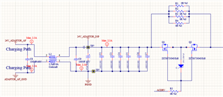

During the power up from the 24V source, ACDRV pin produces 10V but it is not sufficient to turn on the mosfets in the input. The another problem is, IC can not produce REGN voltage. What reason can it be?

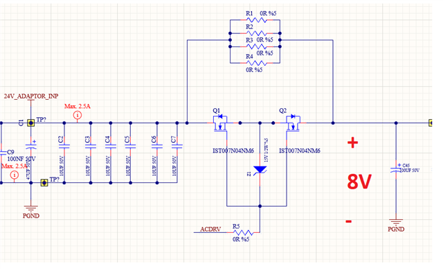

    Yes, I checked it; it is connected. Now Battery is not exist, so I can try it in next week. ACDRV pin has 10V respect to GND, it has about 2V respect to Source pins and C45 has about 8V (difference 10-2V).

    Thanks for the test information. It looks like ACDRV doesn't have enough strength to drive these FETs. I've got a few testing suggestions:
    • Can you remove Q1, Q2, and Z1? This will show there's a problem with the FETs if ACDRV rises up to about 10V with respect to VAC. If ACDRV remains the same, the IC might be damaged.
    • Can you replace the BQ25750 IC? This will show if the IC has been damaged.
