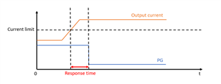

I want to know the current limit response time for TPS7B82-Q1.

We don't have the current limit loop response time characterized for this exact component, however in general current loops within modern LDOs have response times of 20-50us.
