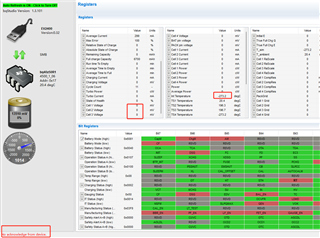

        the connection between EV2400 and the device is good, some times  i saw some changes like cell voltage is 0V and temperature is abnoraml in registers and ack error in Studio.
        when i keep the charge on and off for some time, and once the battery voltage become higher , there is no ack error and charging is stable, no FET toggling.

      Just to clarity that this issue will not only occur during the beginning of charging, bu also occur during standby after full discharge, some phenomenons are bleow:
          1.measure the voltage  on VCC/VC1/VC2/VC3/VC4 pins and the voltage is stable, no big varation.
           2.the  CHG pin is about 2.5 sconds on and 0.5 second off with cycles.
           3. some registers sometimes will have abormal values, such as cell voltage is 0V, temperature is -273.2C.
            4. the battery voltage is around 12.0V.
       Some further tests are performed on this:
         1. once we use a power supply to charge the battery voltage to a litter higer to about 13,2V, then this ON/OFF/ON phenomenon will stop and charging process is back to normal.
          2. during this ON/OFF/ON stage, when I send a RESET command through BQ studio, the issue still exist.
          3. during this ON/OFF/ON stage, when I  re-program the V1.06 firmwre through BQ studio, the issue still exist.
           4. we learned from the BQ40Z50-R1 to BQ40Z50-R2 change list that R1 can update to R2, so we update the firmware from V1.06 to V2.08, and then the ON/OFF/ON issue stop and also rrgisters values are normal.
            Can you kindly provide a detailed explanation to me why V2.08 can slove this prolem?

        I found that in this situation, once I unseal the R1 IC, the R1 IC will become sealed again in one or two seconds, does this mean the IC is reset continuously?
  • Hi Steel,
    Yes, if the gauge is becoming sealed again after unsealing it, then there is a reset occurring. What is the voltage being seen from the cells at this time? Could the gauge be possibly falling into shutdown and exiting?

  • Hi Anthony,
       after unsealing, the voltage of the cells in the BQ studio sometimes show 0V, sometimes normal.
       How to confirm the gauge falling into shutdown and exiting? what's the possible reasons to cause the gauge have such performance?

        Today I compared the settings on our R1 samples and defalut settings on fresh R1 in our stock, I found that once i changed the term voltage from 10400 to default 9000, the ON/OFF/ON issue stops, when i send RESET command, still ok.
          Then once i set the value to 10400 again and send RESET command, the issue appear again.
