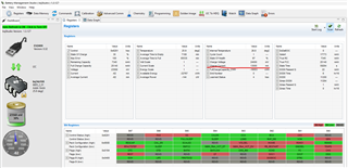

Hi, I am having a problem. I followed this guide to complete a learning cycle: How to Complete a Successful Learning Cycle for the bq34z100 in the link: /cfs-file/__key/communityserver-discussions-components-files/196/6254.How-to-Complete-a-Successful-Learning-Cycle-for-the-BQ34z100.pdf

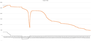

My problem is that I configured every register that the guide says to configure and followed all the steps. However, after completing all of it, my SOC and SOH are not updating correctly. I am unable to complete a successful learning cycle.
I am using the chemical ID 0803, and I have two 12V, 26Ah lead-acid batteries connected in series. I am using this configuration to perform the learning cycle. I would like to know the correct register values to input into my gauge in order to complete the learning cycle successfully.
