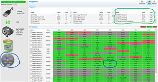

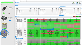

    As observed, the SafetyStatus[UTC] is being set to 1 right after the SafetyAlert is set to 1. This should turn off the CHG FET's right? According to the definition for the "Trip" condition?
    These are the snapshots before and after UTC is set.
    Charge test before UTC:
    Charge test after UTC:
    As you can see here, the SU bit is also being set but FETs are not turning off (XCHG is not being set too). What might be the problem here?
    Note that this is open loop so the gauge relies on the FET to turn off completely. If that's not the case, then charging will continue.
    Is the driver not being able to turn off the FET? Or is it something else? Im not able to understand what and where to troubleshoot, do help me out.

  • A protection event (flag) in SafetyStatus will cause a FET action (if enabled).
    Your screenshots don't show OperationStatus A with the XCHG and XDSG bits. Are you sure that one or both are off?
    If you are in doubt, check the voltage on the FET gate with a volt meter. This should tell you if the gauge controls the FET correctly. If the FET still conducts even though the voltage on the gate is within the "off" specification from the bq78350 datasheet then the problem is with the FET.

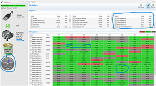

  • Do you have a screenshot that shows both SafetyStatus() UTC = red and OperationStatus() XCHG = green?
    Note: The CHGIN and CHGSU bits are disabled under fet options in this case (Same as previous cases sent above)
    Protections B:
    Before UTC Condition:
    After UTC Condition:

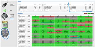

    I got the UTC to work, but this was done by enabling the CHGIN and CHGSU bits from the fet options (Under Settings in Data memory). But as per the TRM this i snot necessary right? We use the BQ40Z80 for another application and in that, the UTC and UTD cut-offs work without the enabling of CHGIN and CHGSU (Not comparing, but just stating our observations)
    Also we tested the UTD as well, and observing the same problem of Fet's not turing off:
    Before UTD condition:
    After UTD conditon:
    (Note: Here XCHG is set because the CHGIN and CHGSU bits are enabled under fet options)

    About CHGIN: This controls inhibiting charging based on temperature. This is a bit confusing because it's a separate feature from protection (e.g. UTC) so if you observe that the CHG FET gets turned off if CHGIN = 1, then you observe the action from a different feature (the charge control temperature inhibit range), not the protector.
  • then you observe the action from a different feature (the charge control temperature inhibit range), not the protector.
    Understood. Then again, I am still not able to get a cutoff for UTC (With CHGIN and CHGSU disbaled [XCHG remains 0 in this case]) and UTD condition with the set protection values.

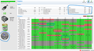

  • Your screenshot for UTC still shows that charging is suspended (SU = 1). Please disable charge suspend.
    About VCT: I checked your log files again. It's not possible to know the exact passed charge within a time window because the gauge doesn't export this particular internal measurement. However, if I calculate the passed charge for a 40s window after both voltage and current meet the charge termination requirements, it's always significantly less than 1mAh. The theoretical minimum required is 0.25mAh. Would it be possible to increase the taper current to 150mA just for a test if this catches a charge termination?
  • Hi Dominik,
    UTC with CHSU and CHGIN disabled:
    Settings:
    (Here the CHSU and CHGIN  bits are disbaled under settings, but as soon as i take the guage to UTC condition, the SU bit sets to red as seen in first image)
