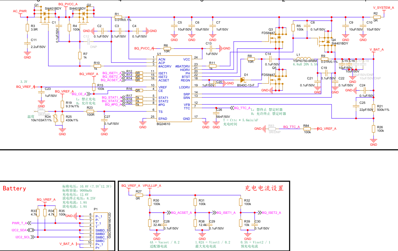

Dear Experts,
We are applying BQ24610, and the schematic diagram is as follows. When the input voltage is 24V and the battery voltage is 12.4V, the load power path (V_SYSTEM)waveform is a sawtooth waveform,and the peak voltage is about equal to the battery voltage. Is this normal? Also, does the input voltage of the adapter need to be greater than the battery voltage for the chip to start normally
